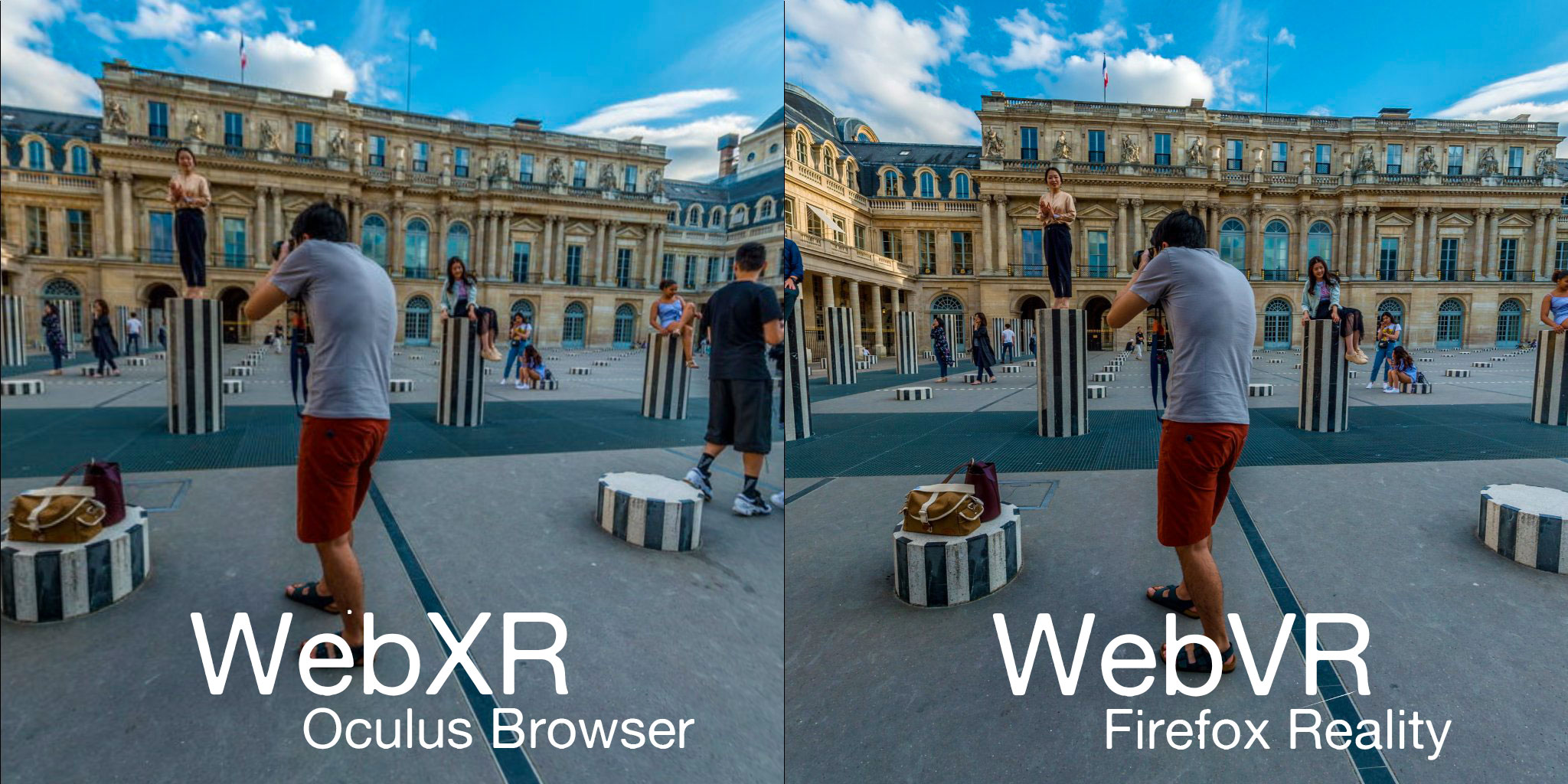

Just updated with krpano 1.20.7 and image quality is still pretty ugly in WebXR ...
Is it because I don't have dedicated cube files for VR or it's just that webXR sucks for now ?
here is my tile sizes :
Quellcode
<image type="CUBE" multires="true" tilesize="512">			<level tiledimagewidth="5120" tiledimageheight="5120">				<cube url="panos/buren1.tiles/%s/l4/%0v/l4_%s_%0v_%0h.jpg" />			</level>			<level tiledimagewidth="2560" tiledimageheight="2560">				<cube url="panos/buren1.tiles/%s/l3/%0v/l3_%s_%0v_%0h.jpg" />			</level>			<level tiledimagewidth="1280" tiledimageheight="1280">				<cube url="panos/buren1.tiles/%s/l2/%0v/l2_%s_%0v_%0h.jpg" />			</level>			<level tiledimagewidth="640" tiledimageheight="640">				<cube url="panos/buren1.tiles/%s/l1/%0v/l1_%s_%0v_%0h.jpg" />			</level>		</image>
and here is a comparaison between WebXR in Oculus Browser and WebVR in Firefox Reality

For me the resolution is fine now...
Are you sure you're actually using version 1.20.7?
Try clearing your browser cache.
And where do you test?
Oculus Go, Oculus Quest or GearVR?
And what Oculus Browser version?

Ok my bad, it was a cache issue...
Quality is ok now, thx Klaus !
