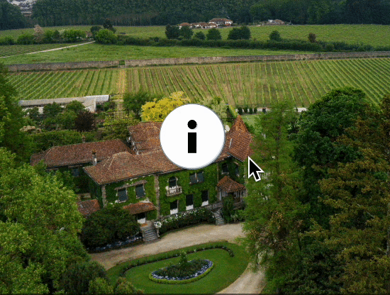

Klaus, thanks for the latest fixes!
I also did a test and strange behavior, when you click on the button, the hotspot with the letter "i" should be shown and hidden, and the hotspot with the arrow is hidden.
Although the trace outputs the name of the hotspot with the letter "i"
if you put a "set" instead of "tween", then it works correctly
example
Quellcode
5
6
7
8
9
10
11
12
13
14
15
16
<layer name="test1" type="text" align="top" x="-30" html="on infohs" onclick="hid_show_hs(1)"/>
<layer name="test2" type="text" align="top" x="30"  html="off infohs" onclick="hid_show_hs(0)"/>
  <hotspot name="infohs" keep="true" type="image" url="i.png" />
  <hotspot name="hsp_1"  type="image" url="arrov.png"  ath="-30"   />
  <action name="hid_show_hs" scope="local"  args="stat" >
	for(set(i, 0), i LT hotspot.count, inc(i),
	  copy(hs, hotspot[get(i)]);
	  if(hs.name == 'infohs',
	    trace(hs.name);
	    tween(hs.alpha, get(stat));
