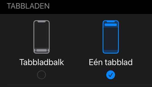

.. yes i know the new iphone fullscreen in landscape behaviour but this only works when you have one tab,url bar at top.. and not when tab bar , url bar at bottom (in portrait).
Also the swipe up seems to randomly show or not show, even when landscape fullscreen (one tab top)

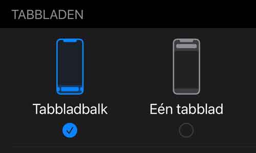

5
Tuesday, May 30th 2023, 2:42pm
I'll make my self more clear.
https://www.virtualtuur.com/krpano/121/h…pe/1/index.html
if I have in the settings this:
..the iPhone fullscreen when going in landscape works fine. I also had some issue the swipe still showing in some cases but can't get it back in the bare bone.
when I have this
going to landscape the fullscreen doesn't work, and the swipe shows.
when I take the viewport-fit=cover out of the html, the swipe up doesn't show.
https://www.virtualtuur.com/krpano/121/h…pe/2/index.html
Could it be possible to:
1. make the iPhone fullscreen swipe work without viewport-fit=cover or perhaps with another setting?
2. make the iPhone also go fullscreen when you have the tab-bar selected in the settings instead of the one tab?
Tuur *thumbsup*

I can confirm the problem on iphone 11 & iPhone 14. I tried to work around the problem with onresize-event and stagewidth GT stageheight, which will show the swipe-info, but the actual swipe still does´nt work *mellow*

Friday, June 2nd 2023, 9:10am
currently the iphone fullscreen 'mode' is only supported when actually using the 'full-screen' ;-)
That means when using viewport-fit=cover.
I don't know yet if that might be also possible without that, but I will check...
Technically, this iphone full screen hack is pretty tricky and changes depending on the iOS version and also differs whether the Safari tabs are at the top or bottom (and there are also some special implementations for other iOS browsers). It's necessary to explicitly detect the current state somehow and then 'allow' temporary scrolling the whole page (but only as long until reaching the 'full-screen' state).
That means that support is a special case and probably can't manually simulated in a easy/simple way.
