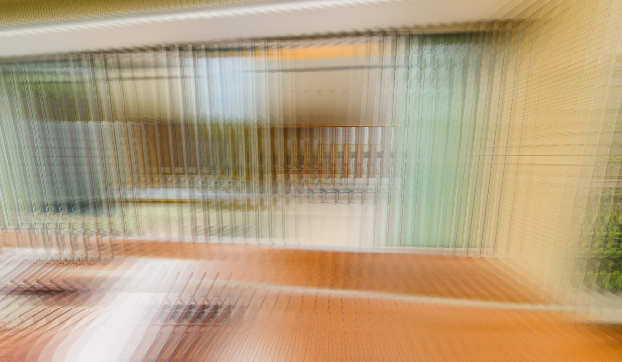

  • Hi Klaus!
    I tried to realize the effect of blurring based on the above link - https://github.com/mattdesl/lwjgl…fragment-shader
    but I get strange stripes.
    Here is my code:
    Code
    krpano.webGL.context.uniform2f(shader.dir, 1, 0);
    krpano.webGL.context.uniform1f(shader.resolution, 1024);
    krpano.webGL.context.uniform1f(shader.radius, 20);
    Code
    shader = krpano.webGL.createPostProcessingShader( get_shader_src(), "sharpen_factor,sz,dir,resolution,radius");
    Could you tell me what I'm doing wrong?
    Thank you!
    Edited 2 times, last by nosferatu (April 6, 2017 at 9:09 AM).
  • I fixed some bugs in the code and edited my post above.
    Yet I do not get the desired result.
    Once I write the variable "vColor", I get a black screen:
    Code
    gl_FragColor = vColor * vec4(sum.rgb, 1.0);
    Without this variable I get a strange effect:
    Code
    gl_FragColor = vec4(sum.rgb, 1.0);
    Help me please.
  • Hi,
    A lot of things are wrong there: *wink*
    • your shader code is from a two-pass shader example, so one pass can't be enough
    • the 'resolution' of the framebuffer is not 1024x1024, it's the current krpano rendering buffer size - krpano provides that size via the 'sz' uniform
    • not sure what you want todo with your 'vColor' variable...
    I will quickly made a plugin based on your core shader code and then post it here.
