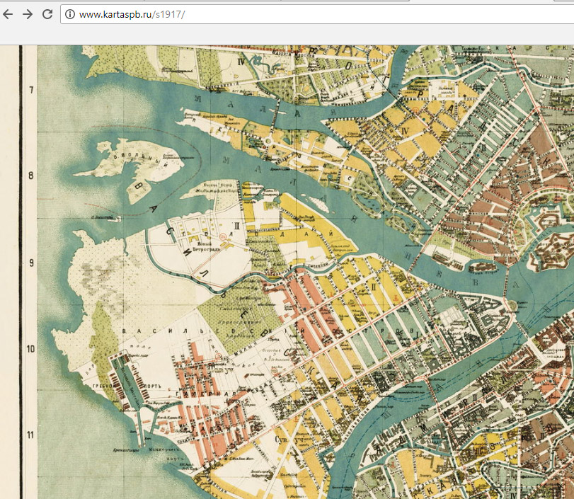

  • In krpano 1.19-pr13 I've found some strange behaviour:
    when I've made a flat multires panorama from a geographical map
    http://www.kartaspb.ru/s1917/
    script loads map tiles in a strange way (clear cache and look at the upper-left segment near the island).
    Here is a series of screenshots:

    http://www.kartaspb.ru/bug_1.jpg

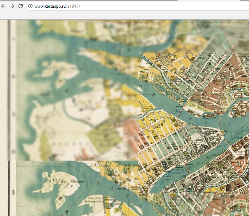

    2. then it loads a strange (incorrect) tile from another part of the map
    http://www.kartaspb.ru/bug_2.jpg

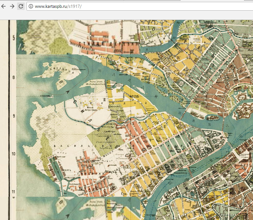

    3. then it loads correct tile, but with different borders than in step 1
    http://www.kartaspb.ru/bug_3.jpg

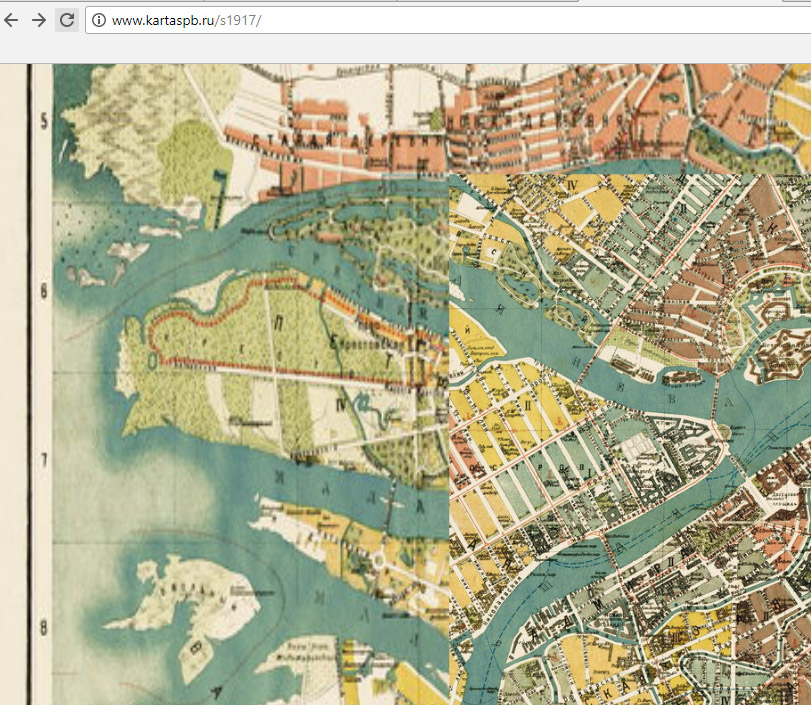

    4. and, finally, everything goes ok
    http://www.kartaspb.ru/bug_4.jpg
    It looks very strange and unpleasant when loading map at first time and when loading a new segments of map at zoom-in for the first time.
    When map is cached it looks like some king of flickering in those tiles on reload.
    Some previous version of krpano have no such effect:
    http://www.kartaspb.ru/1917/
    Hope, it can be fixed, because krpano is a really good product!
