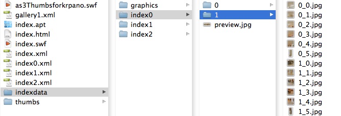

  • I am using Autopano to create the basic tours. I have the gallery.xml file working to where the thumbs are showing on the opening tour image. But I cannot figure out how to make the thumb image link to the next tour. Does anybody have experience with this? I sure could use some help getting the links to work. Below is my gallery.xml with the linking not working:

    In case it will help here is a screen shot of the directory structure:
    Thanks,
    Rich
