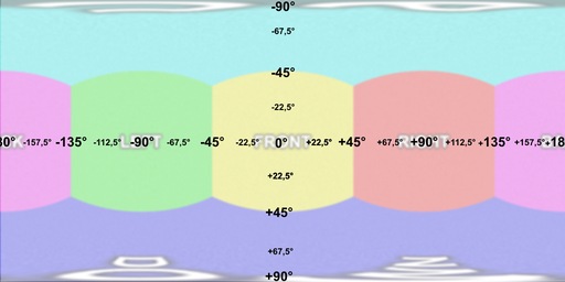

Attribute nameTypeDefault value
northNumber0.0
  • Define where North is located in the pano-image (from -180 to +180).
  • The default is 0.0, which refers to the center of the pano-image.
  • Note - this is only relevant when using using absolute direction tracking.
  • The coordinate system:
