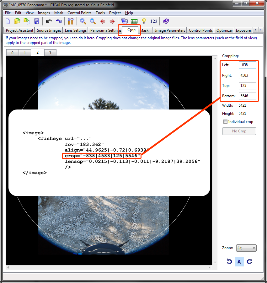

    <fisheye url="fisheye.jpg"
             fov="180.0"
             align="yaw|pitch|roll"
             crop="left|right|top|bottom"
             lenscp="a|b|c|d|e"
  • Fisheye image support.
  • Directly use fisheye photos or videos.
  • For correctly straighten and aligning the fisheye image, it's necessary to know some parameters about it. A good tool for getting these parameters is PTGUI.
Fisheye Image with Stereo-Images
<image stereo="true" stereoformat="TB">
             fov="180.0"
             lenscp="a|b|c|d|e"
  • Stereo support - works for images and videos.
  • The stereoformat setting need to be used to define the arrangement of the left or right images (Top-Bottom or Side-by-Side).

Fisheye image support (HTML5 and WebGL only).
Fisheye settings:
  • fov="180.0"
    • The field-of-view of the fisheye image (in degrees).
    • Related to the crop size.
    • Source: Can be directly taken from the PTGUI fov image parameter.
  • align="yaw|pitch|roll"
    • The aligment / rotation / leveling of the image (in degrees).
    • Source: Can be directly taken from the PTGUI image parameters.
      (e.g. use vertical-line control points to align / level the image)
  • crop="left|right|top|bottom"
    • The edges of the fisheye fov cropping circle (in pixels).
    • The circle relates to the fov size.
    • Source: Can be directly taken from the PTGUI crop settings.
  • lenscp="a|b|c|d|e"
    • The lens correction parameters.
    • Source: Can be directly taken from the PTGUI lens settings.
PTGUI Screenshots for getting the fisheye parameters:

crop
onovercrop

Crop / cut out a rectangular area of the source image. Usefull to use only one single image for serval image elements.
onovercrop / ondowncrop - different crop areas for mouse over and mouse button down states.
crop="x-position|y-position|width|height"
